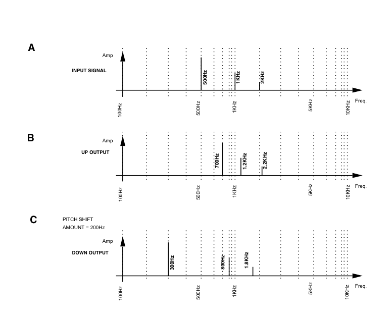

extrait du manual ALESIS :
RING MODULATOR
The Ring Modulator is a specialized amplitude modulator that produces an output that contains only the sum and difference frequencies of its input waveforms' harmonics. It is most useful for generating metallic, bell-like sounds. The Ring Modulator in the QuadraVerb Plus creates two signals (Up and Down) from the initial input signal. The up output signal is a version of the input signal with its harmonic spectrum shifted up, while the down output signal is the input signal with its harmonic spectrum shifted down. The amount of shift is identical for the up, and down outputs, and is specified in Hertz by the Shift Amount parameter.
The following illustration shows how the output spectrums relate to the input spectrum.Effet Matrix Ring10In Figure 1A, the fundamental (or frequency that we perceive as the instrument's pitch) is 500 Hz. The harmonics are normally even multiples of the fundamental, or 2 times the fundamental, 3 times the fundamental, 4 times the fundamental, etc. In this case, the 2nd harmonic is 1KHz (1000 cycles per second), or twice the fundamental of 500Hz, and the 4th harmonic is 2KHz, or 4 times the fundamental.
In Figure 1B, the Pitch Shift amount has been set to 200Hz, which means that the fundamental and all of its related harmonics are shifted up by the same 200Hz amount. This means that the fundamental has been shifted to 700Hz, the 2nd harmonic is now at 1.2KHz (normally it should be 2 times the fundamental, or 1.4KHz), and the 4th harmonic is 2.2KHz (normally it should be 2.8KHz).
In Figure 1C, the Pitch Shift amount is shifted down by 200Hz, which means that the fundamental and all of its related harmonics are shifted down by the same 200Hz amount. This means that the fundamental has been shifted to 300Hz, the 2nd harmonic is now at 800Hz (normally it should be 2 times the fundamental, or 600Hz), and the 4th harmonic is 1.8KHz (normally it should be 1.2KHz).
Since the ratio between the input signal's harmonics is not preserved, the resulting sound is drastically different from the original. While usual ring modulators only provide a fixed mix of the Up and Down spectrums, the algorithm implemented in the QuadraVerb Plus gives independent access to the Up and Down version of the original spectrum. The ring modulator treatment will be most valuable for special effect on voices or sound effects.
